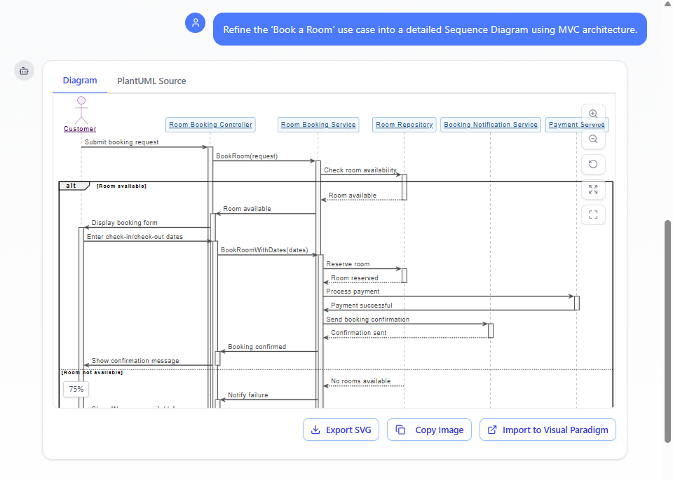

Visual Paradigm’s AI Chatbot excels at this refinement step. It takes your conceptual use-case description or existing Activity/Use Case Diagram and—through guided or fully automated prompts—produces a refined Sequence Diagram that maps the high-level flow onto a chosen architectural pattern (most commonly MVC), complete with realistic method signatures drawn from the underlying Class Diagram.

  2. Issue a Refinement Prompt In the AI Chatbot, use prompts that explicitly request layering and detail:
    • “Refine the ‘Place Order’ use case into a detailed Sequence Diagram using MVC architecture. Show interactions from Customer (View), OrderController, OrderService (Model), PaymentGateway, and InventoryRepository. Include detailed message signatures with parameters and return types.”
    • “Map the checkout flow from the Activity Diagram to a Sequence Diagram in layered MVC style: Browser (View) → CheckoutController → OrderService → PaymentService → InventoryService. Show parameter passing, return values, and exception handling for payment failure.”
    • “Take the ‘Login with 2FA’ use case and generate a refined Sequence Diagram separating Presentation (LoginView), Application (AuthController), Domain (AuthService, UserRepository), and Infrastructure (SMSProvider). Use full method signatures like authenticate(username: String, password: String): AuthResult.”
    • “Refine the ‘Borrow Book’ use case showing MVC layers: LibraryUI → LoanController → LoanService → BookRepository → MemberRepository. Include preconditions, postconditions, and transaction boundaries.”
  3. AI Generates the Layered, Detailed Sequence Diagram The output includes:
