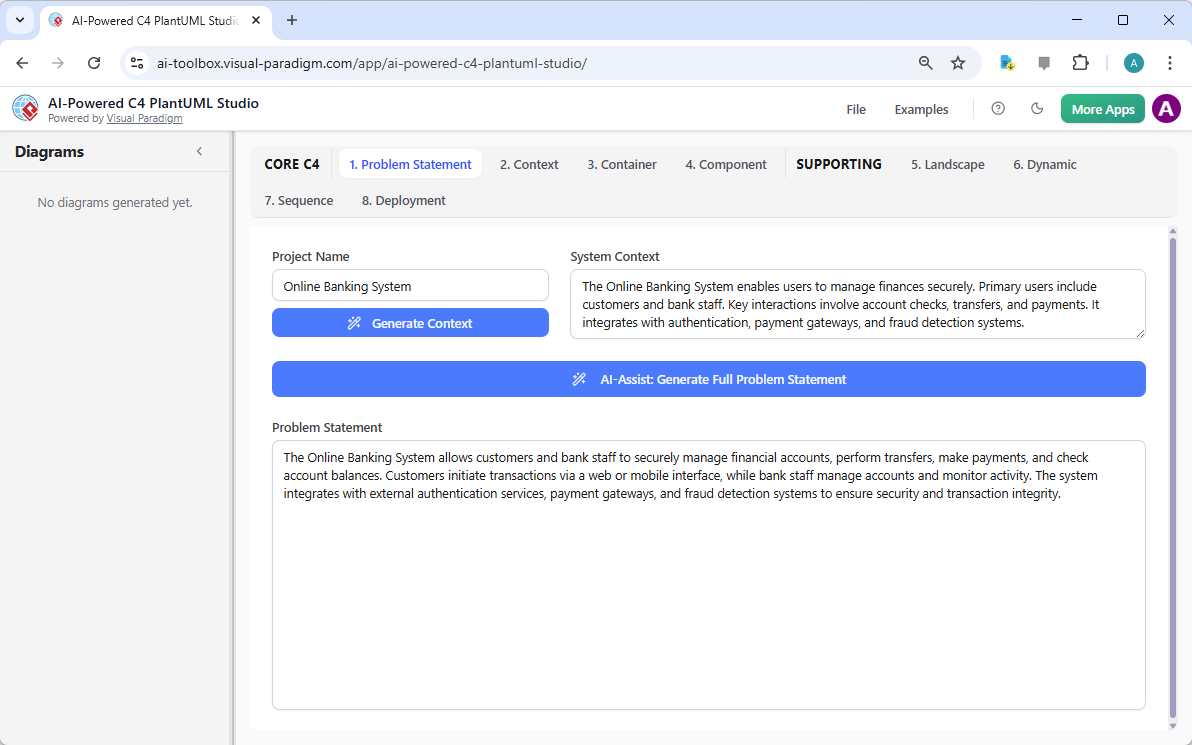

  2. Start on the “Problem Statement” tab. Write a detailed description of your system. Enter your project name and click Generate Context. Then, click Ai-Assist: Generate Full Problem Statement.
    Visual Paradigm AI-Powered C4 PlantUML Studio: Providing problem statement

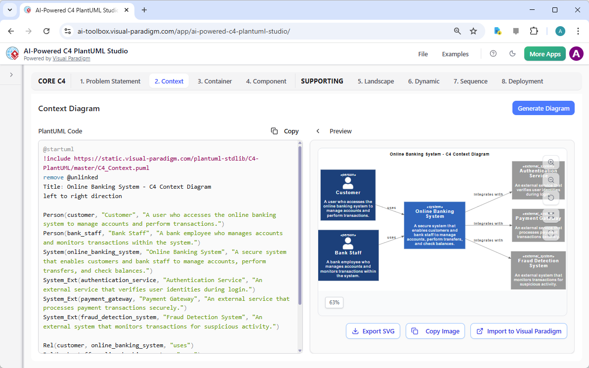

  3. Navigate to the “Context” tab and click “Generate Diagram“. Review the output and make any necessary manual edits to the PlantUML code.
    Visual Paradigm AI-Powered C4 PlantUML Studio: C4 Context Diagram

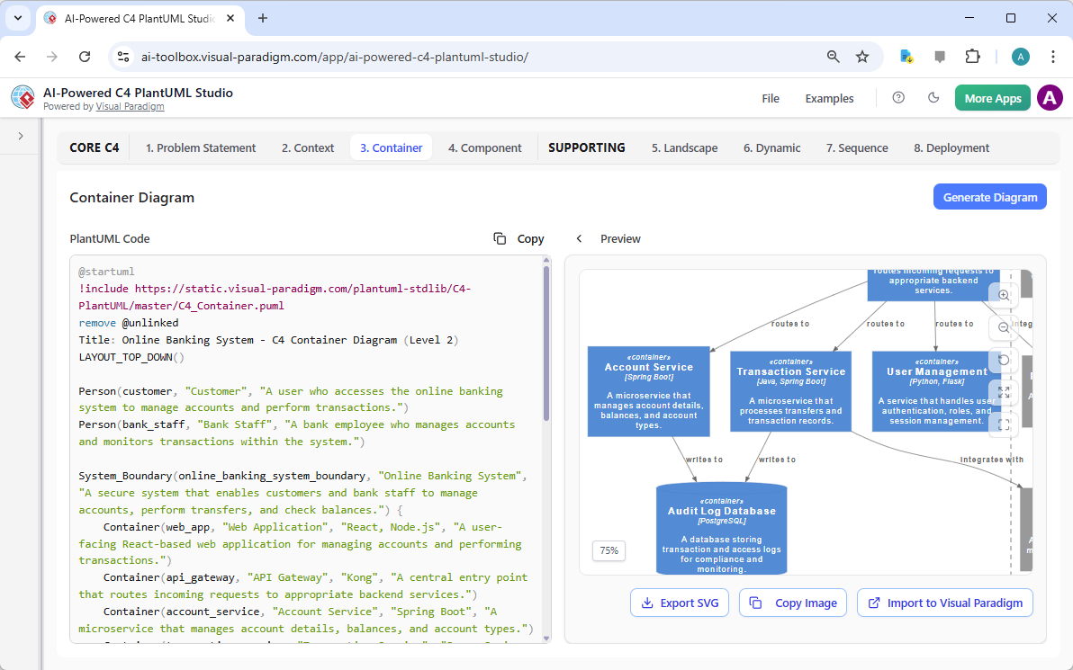

  4. Navigate to the “Container” tab. The AI will use both your problem statement and the context diagram to generate a more detailed container diagram. Click “Generate Diagram” and refine the code.
    Visual Paradigm AI-Powered C4 PlantUML Studio: C4 Container Diagram

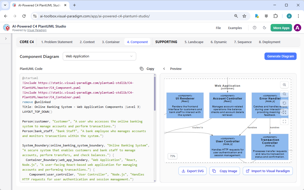

  5. Repeat the process for the “Component” tab, where the AI will generate an even more granular view.
    Visual Paradigm AI-Powered C4 PlantUML Studio: C4 Component Diagram
