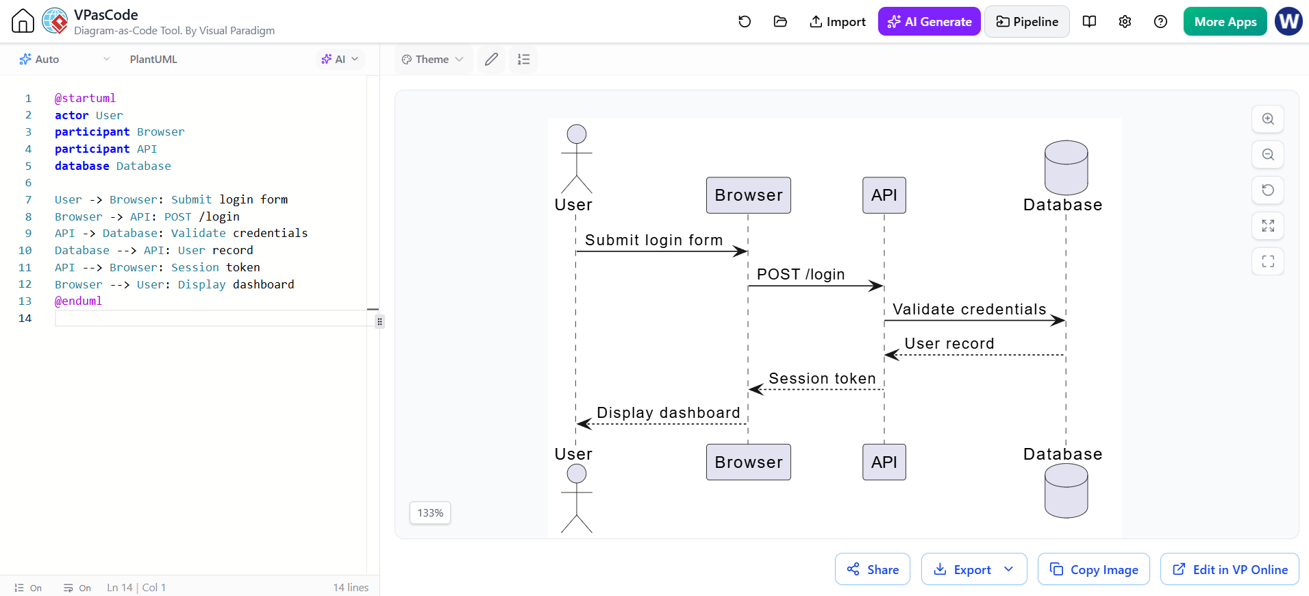

A simple PlantUML sequence diagram looks like this:
VPasCode interface displaying PlantUML code on the left and its rendered sequence diagram showing User, Browser, API, and Database interactions on the right.
@startuml
actor User
participant Browser
participant API
database Database
User -> Browser: Submit login form
Browser -> API: POST /login
API -> Database: Validate credentials
Database --> API: User record
API --> Browser: Session token
Browser --> User: Display dashboard
@enduml

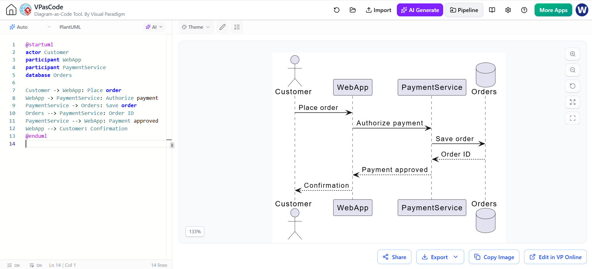

Participants can be declared explicitly:
VPasCode interface displaying PlantUML code for a sequence diagram alongside its rendered visualization of Customer, WebApp, and PaymentService interactions.
@startuml
actor Customer
participant WebApp
participant PaymentService
database Orders
Customer -> WebApp: Place order
WebApp -> PaymentService: Authorize payment
PaymentService -> Orders: Save order
Orders --> PaymentService: Order ID
PaymentService --> WebApp: Payment approved
WebApp --> Customer: Confirmation
@enduml
Explicit declarations improve readability and make it easier to control aliases, types, and visual appearance.

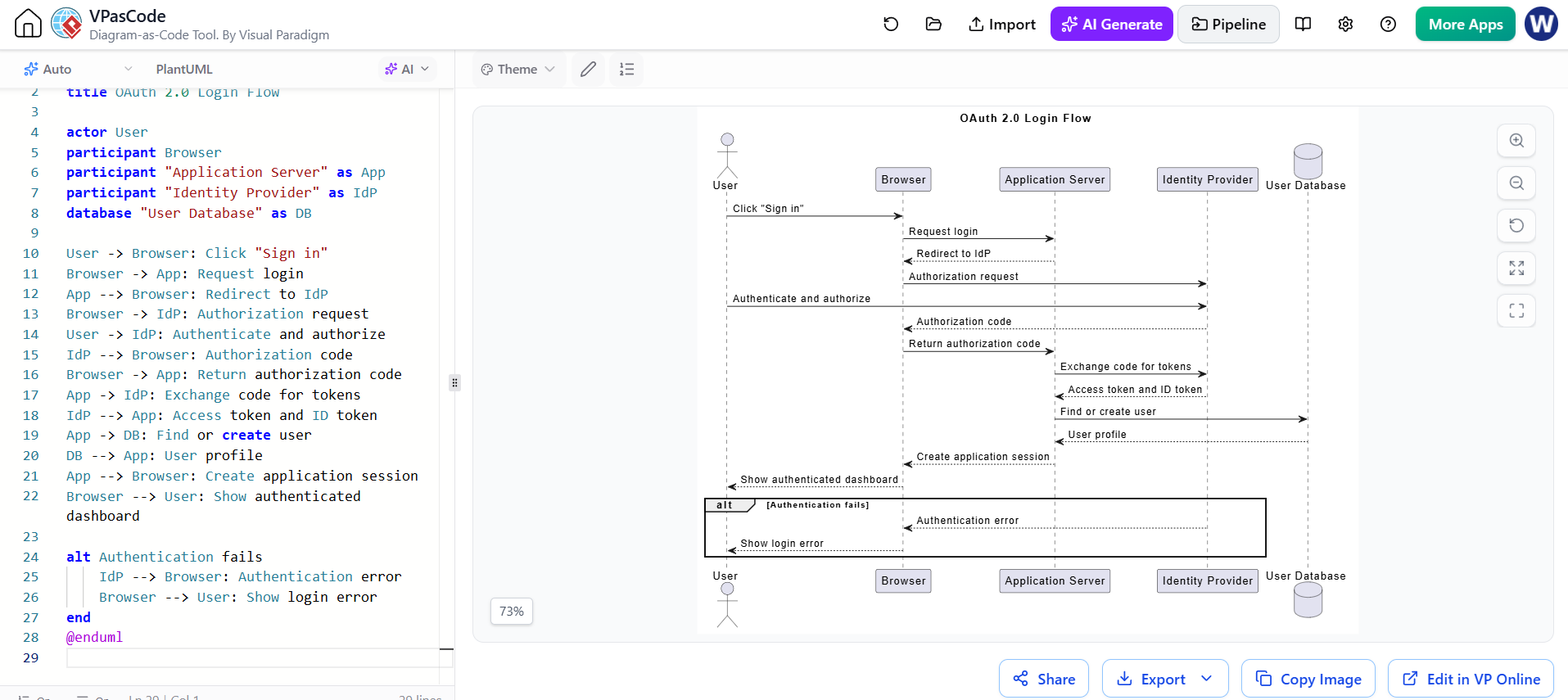

7. Example: AI-generated sequence diagram
A refined result for the OAuth login prompt could look like this:
VPasCode interface displaying generated PlantUML code and corresponding OAuth 2.0 sequence diagram illustrating user authentication flow.
@startuml
title OAuth 2.0 Login Flow
actor User
participant Browser
participant "Application Server" as App
participant "Identity Provider" as IdP
database "User Database" as DB
User -> Browser: Click "Sign in"
Browser -> App: Request login
App --> Browser: Redirect to IdP
Browser -> IdP: Authorization request
User -> IdP: Authenticate and authorize
IdP --> Browser: Authorization code
Browser -> App: Return authorization code
App -> IdP: Exchange code for tokens
IdP --> App: Access token and ID token
App -> DB: Find or create user
DB --> App: User profile
App --> Browser: Create application session
Browser --> User: Show authenticated dashboard
alt Authentication fails
    IdP --> Browser: Authentication error
    Browser --> User: Show login error
end
@enduml
The AI may produce a technically valid diagram that still misrepresents the actual implementation. For example, it might show the browser communicating directly with a database or omit token validation. Validate the result against the real system.

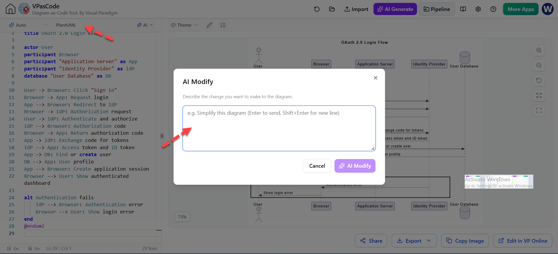

8. Editing an existing diagram with AI
AI is often more useful for controlled modifications than for generating an entire diagram from scratch.
VPasCode AI Modify dialog overlaying a PlantUML sequence diagram, enabling users to describe and apply targeted code changes via plain language commands.
Examples of targeted instructions include:
Add a Redis cache between the API gateway and Product Service. Show a cache hit and cache miss path.
Group all database components into a Data Layer package.
Remove implementation details and leave only the major business services.
Add an alternative path for payment failure and order cancellation.
Rename "Auth Service" to "Identity Service" everywhere without changing other relationships.
Convert this sequence diagram into a component diagram that shows responsibilities rather than message-by-message interactions.
VPasCode describes AI-assisted diagram modification as a way to update existing scripts using plain-language commands. Some workflows may also provide a visual or line-level comparison before accepting changes.
A safe modification workflow is:
  1. Keep the original source unchanged.
  2. Ask AI for one focused modification.
  3. Inspect the proposed code changes.
  4. Render the result.
  5. Check that unrelated relationships were not altered.
  6. Accept the change only after visual and semantic review.
  7. Commit the updated source with a meaningful message.

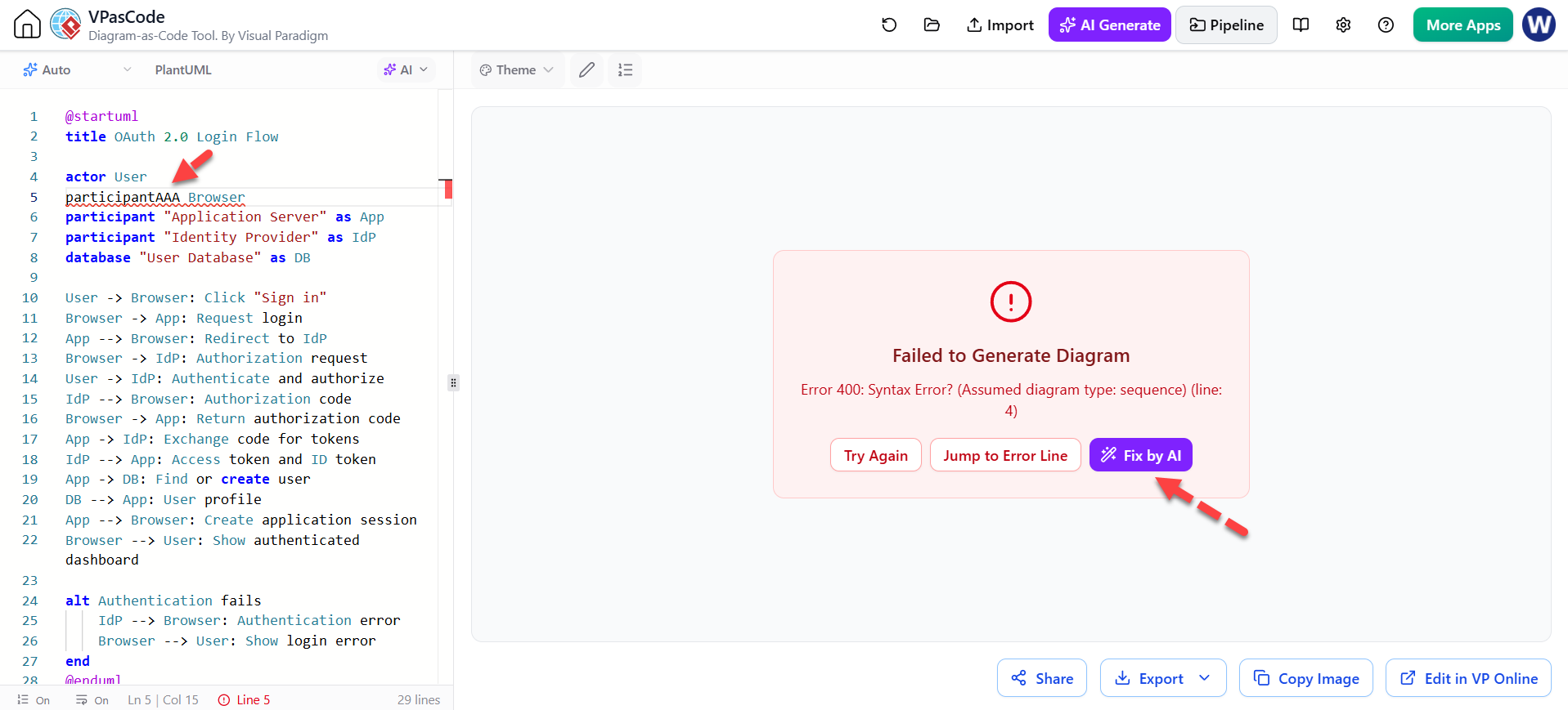

9. Using AI to fix PlantUML errors
VPasCode interface showing a PlantUML syntax error with a red underline and a "Fix by AI" button to resolve the issue.
PlantUML errors commonly result from:
  • Missing @enduml
  • Misspelled keywords
  • Invalid participant declarations
  • Unbalanced grouping blocks
  • Incorrect brackets or parentheses
  • Unsupported syntax copied from another diagram language
  • Incorrectly escaped special characters
  • Mixing Mermaid, PlantUML, and Graphviz syntax
For example, this script contains a malformed declaration:
@startuml
participant Browser
particpant API
Browser -> API: Request
@enduml
The correction is:
VPasCode interface displaying PlantUML code for a Browser-to-API request alongside the rendered sequence diagram.
@startuml
participant Browser
participant API
@enduml
When using an AI repair feature, provide the intended behavior as well as the broken code. This helps prevent a syntactic fix that changes the meaning of the diagram:
Fix the PlantUML syntax error, but preserve the participants, message order, and labels. Explain which line was invalid.
VPasCode documents AI-assisted syntax repair for malformed diagram scripts. Such repairs should still be reviewed, especially when the AI changes more than one line.

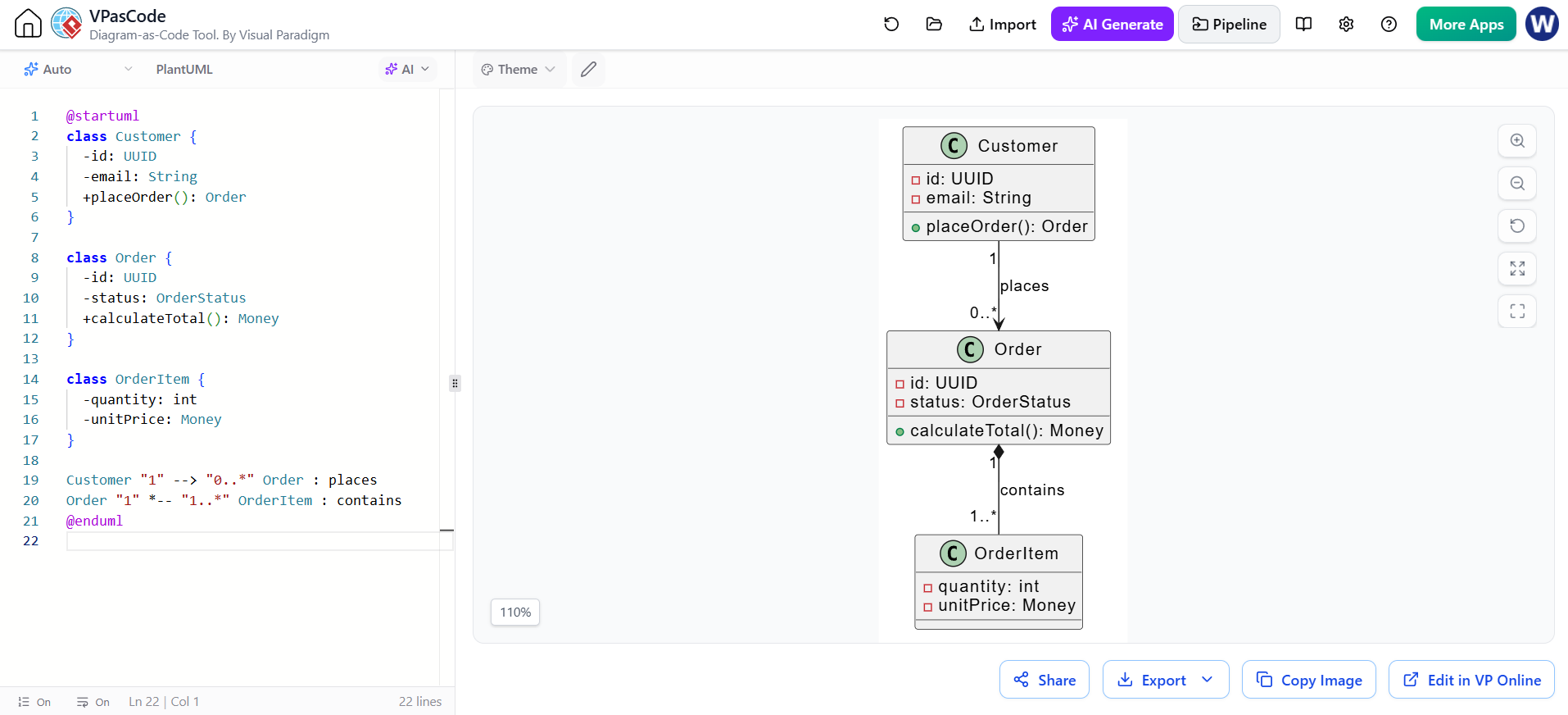

10.2 Class diagrams
Class diagrams express structure, attributes, methods, and relationships.
VPasCode interface displaying PlantUML code for Customer and Order classes alongside their rendered class diagram showing relationships.
@startuml
class Customer {
  -id: UUID
  -email: String
  +placeOrder(): Order
class Order {
  -id: UUID
  -status: OrderStatus
  +calculateTotal(): Money
class OrderItem {
  -quantity: int
  -unitPrice: Money
Customer "1" --> "0..*" Order : places
Order "1" *-- "1..*" OrderItem : contains
@enduml

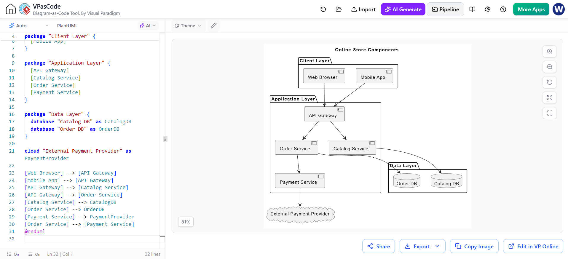

10.3 Component diagrams
Component diagrams are effective for high-level software architecture.
VPasCode interface displaying PlantUML code generating an online store component diagram with client, application, and data layers.
@startuml
title Online Store Components
package "Client Layer" {
  [Web Browser]
  [Mobile App]
package "Application Layer" {
  [API Gateway]
  [Catalog Service]
  [Order Service]
  [Payment Service]
package "Data Layer" {
  database "Catalog DB" as CatalogDB
  database "Order DB" as OrderDB
cloud "External Payment Provider" as PaymentProvider
[Web Browser] --> [API Gateway]
[Mobile App] --> [API Gateway]
[API Gateway] --> [Catalog Service]
[API Gateway] --> [Order Service]
[Catalog Service] --> CatalogDB
[Order Service] --> OrderDB
[Payment Service] --> PaymentProvider
[Order Service] --> [Payment Service]
@enduml

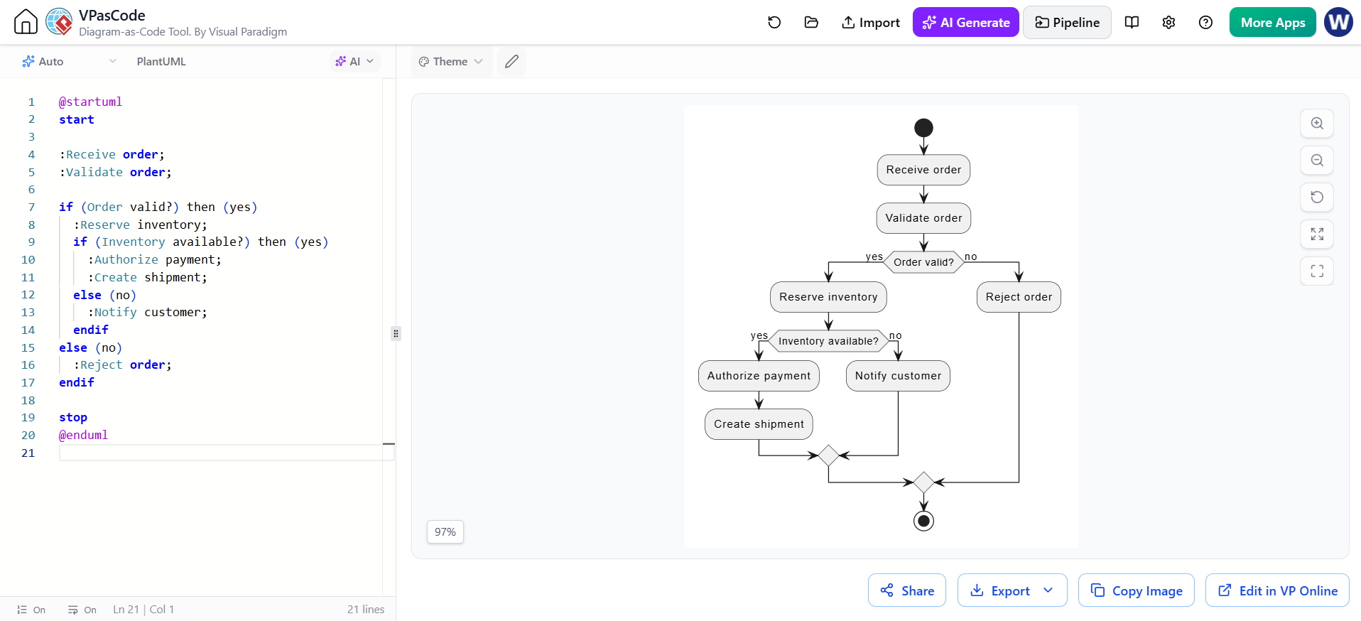

10.4 Activity diagrams
Activity diagrams show workflows and branching logic.
VPasCode interface displaying PlantUML code and corresponding activity diagram illustrating order processing workflow with validation and inventory branching logic.
@startuml
start
:Receive order;
:Validate order;
if (Order valid?) then (yes)
  :Reserve inventory;
  if (Inventory available?) then (yes)
    :Authorize payment;
    :Create shipment;
  else (no)
    :Notify customer;
  endif
else (no)
  :Reject order;
endif
stop
@enduml

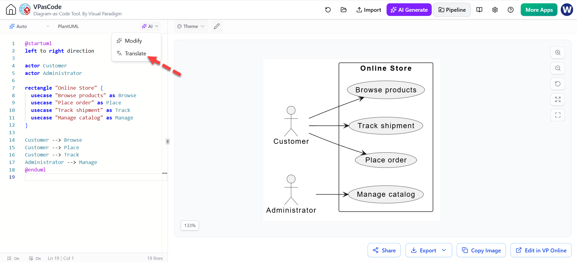

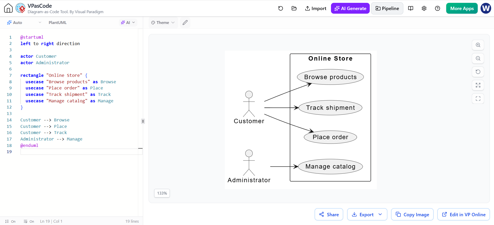

10.5 Use-case diagrams
VPasCode interface displaying PlantUML code and resulting use-case diagram for an Online Store, showing Customer and Administrator interactions.
Use-case diagrams identify actors and system capabilities.
@startuml
left to right direction
actor Customer
actor Administrator
rectangle "Online Store" {
  usecase "Browse products" as Browse
  usecase "Place order" as Place
  usecase "Track shipment" as Track
  usecase "Manage catalog" as Manage
Customer --> Browse
Customer --> Place
Customer --> Track
Administrator --> Manage
@enduml

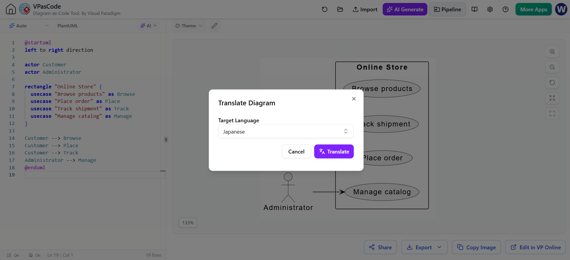

16. Translating PlantUML diagrams
AI translation can be useful when labels need to be presented to international teams. However, translate diagram text rather than technical syntax.
VPasCode interface showing AI Translate dropdown menu selection to translate PlantUML diagram text while preserving technical syntax.
VPasCode Translate Diagram dialog box overlaying a PlantUML use case diagram, showing Japanese language selection for international team collaboration.
VPasCode interface displaying a PlantUML use case diagram with Japanese text labels for actors and actions alongside the code editor.
For example, translate this:
into another language while preserving:
  • Customer
  • OrderService
  • Arrow syntax
  • PlantUML keywords
  • Aliases
  • URLs
  • API names
  • Product names
  • Acronyms
A translation prompt should be explicit:
Translate only visible labels and message text into Japanese. Do not change PlantUML keywords, aliases, relationship syntax, API names, product names, or code identifiers.
Review translations of domain-specific terms carefully. A literal translation may be grammatically correct but technically misleading. VPasCode describes AI translation as a capability for converting diagram text and labels across languages.
