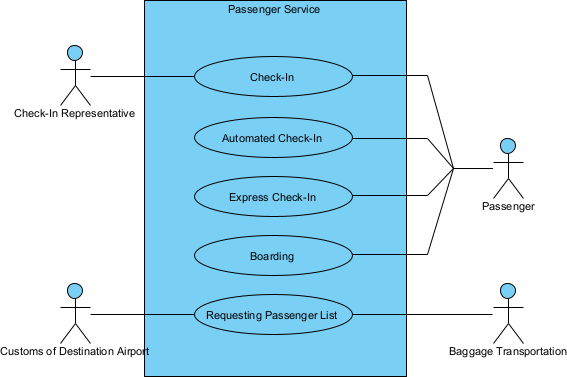

The Use Case View (one of the core architectural views in UML) focuses exclusively on what the system does from the outside—from the perspective of actors (users, external systems, or devices) who interact with it. It deliberately ignores internal implementation details, data structures, algorithms, or technical architecture. Instead, it captures functional requirements in terms of user goals and observable system behavior.
Passenger service UML use case diagram
