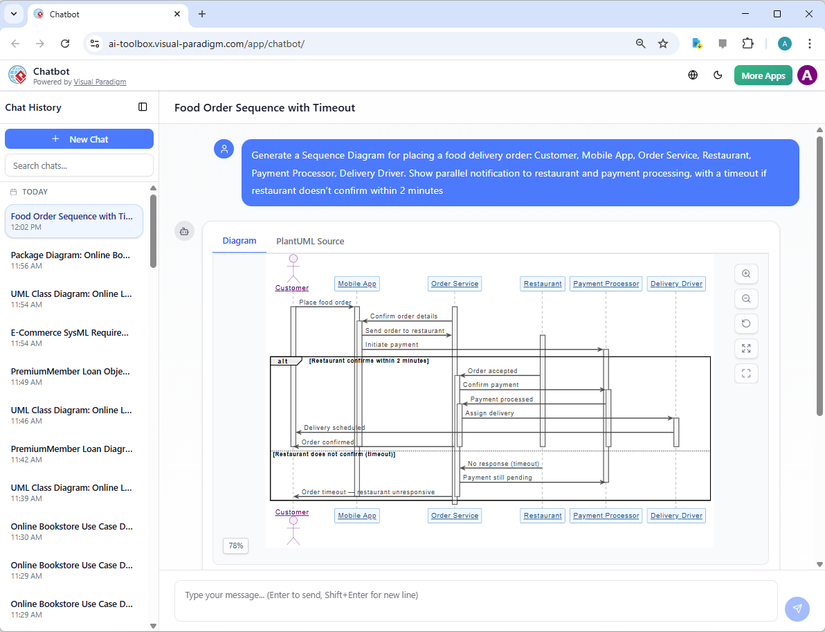

    • “Create a Sequence Diagram for user login with two-factor authentication. Actors: User, Web Browser, Authentication Service, SMS Gateway. Flow: User enters credentials → Browser sends to Auth Service → Auth Service requests OTP from SMS Gateway → SMS Gateway sends OTP → User enters OTP → Auth Service validates → returns success or failure.”
    • “Show the checkout sequence in an e-commerce system: Customer, ShoppingCart, OrderService, PaymentGateway, InventoryService. Include happy path, payment failure retry, and out-of-stock abort.”
    • “Generate a Sequence Diagram for placing a food delivery order: Customer, Mobile App, Order Service, Restaurant, Payment Processor, Delivery Driver. Show parallel notification to restaurant and payment processing, with a timeout if restaurant doesn’t confirm within 2 minutes.”

  4. Refine Iteratively with Natural Language Commands Treat the diagram as a living conversation:
    • “Add a retry loop if OTP validation fails (max 3 attempts).”
    • “Insert two-factor step only if user has 2FA enabled (use opt fragment).”
    • “Show parallel messages: after payment success, notify customer and update inventory simultaneously.”
    • “Change the PaymentGateway lifeline to show a timeout after 30 seconds.”
    • “Add a self-message on OrderService to calculate total before calling PaymentGateway.”
    • “Make the layout horizontal and add a title: ‘Checkout with Payment Retry’.”
    • “Highlight the critical section where payment is processed.”
