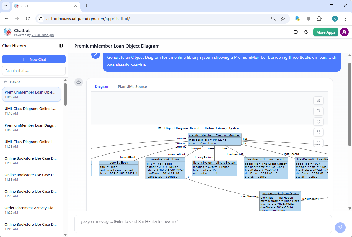

  1. Start the AI Chatbot.
  2. Request a Validation Snapshot via Natural Language In the AI Chatbot, describe a concrete scenario you want to test:
    • “Generate an Object Diagram for an online library system showing a PremiumMember borrowing three Books on loan, with one already overdue.”
    • “Create a snapshot where an Order has two OrderItems, one Product is out of stock, and payment has been authorized via CreditCard.”
    • “Show a valid Hospital scenario: one Patient with two Appointments booked with different Doctors, and one MedicalRecord containing three Prescriptions.”
    • “Test the multiplicity constraint: try to create a Department with 25 Employees (should violate if max is 20).”
  3. AI Produces One or More Snapshots The AI creates one or more Object Diagrams that:
    • Instantiate classes as objects (e.g., :Book, :PremiumMember)
    • Assign realistic attribute values (e.g., book.title = “Clean Code”, loan.dueDate = “2026-01-20”)
    • Create links corresponding to associations (with correct multiplicity and role names)
    • Respect constraints (OCL, notes, or implied invariants) where defined
    • Highlight valid vs. invalid cases when testing boundaries (e.g., red dashed lines or annotations for violations)
    • Use clean layout: objects aligned, links routed without overlap, attribute compartments shown only when relevant
