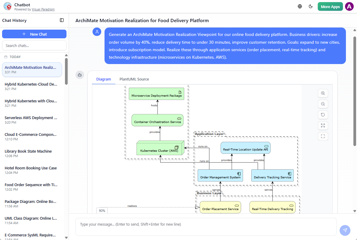

  1. Describe Business Context, Goals, or Desired Viewpoint In the AI Chatbot (or via dedicated ArchiMate/TOGAF apps in the Innovation Hub), provide a natural-language starting point:
    • “Generate an ArchiMate Motivation Realization Viewpoint for our online food delivery platform. Business drivers: increase order volume by 40%, reduce delivery time to under 30 minutes, improve customer retention. Goals: expand to new cities, introduce subscription model. Realize these through application services (order placement, real-time tracking) and technology infrastructure (microservices on Kubernetes, AWS).”

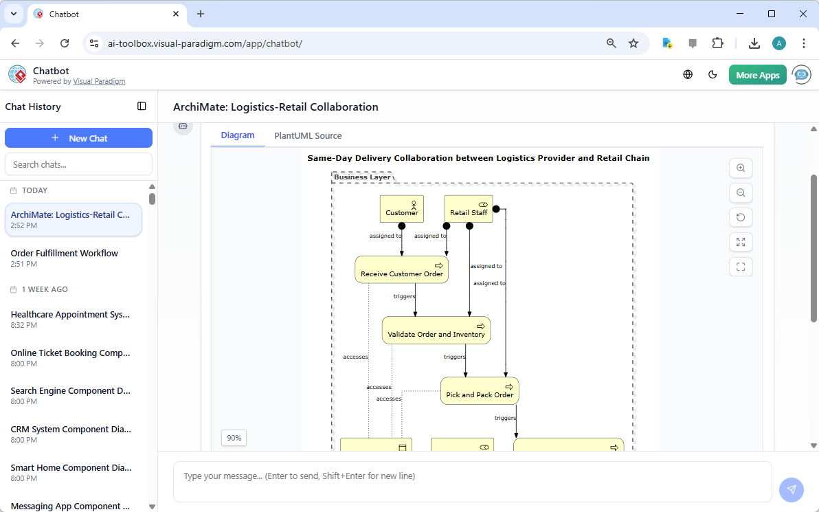

    • “Create a layered ArchiMate viewpoint showing how the ‘Order Fulfillment’ business process is realized by application components (Order Service, Payment Service, Notification Service) and deployed on AWS EKS, RDS, and SQS. Include business actors (Customer, Restaurant, Driver) and triggering flows.”

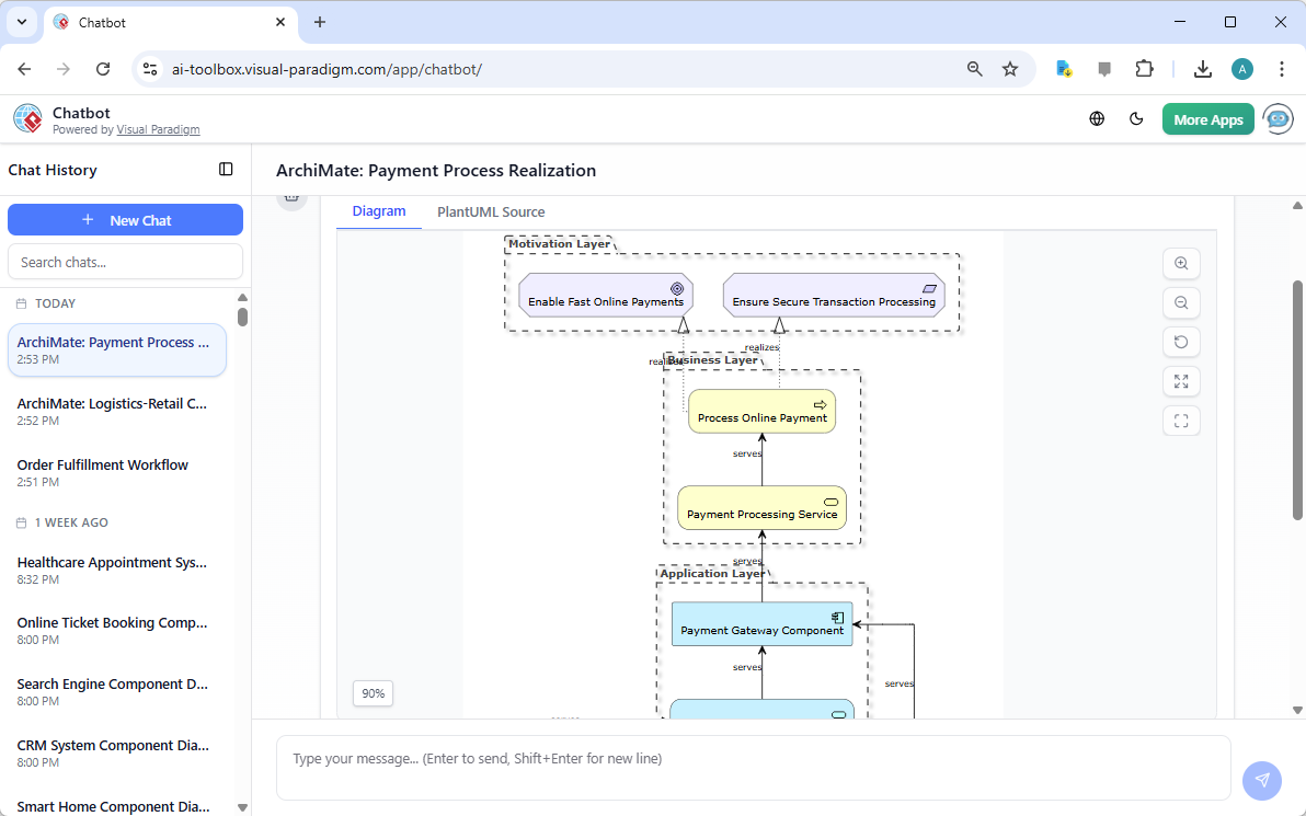

    • “Produce a TOGAF-aligned Application Cooperation Viewpoint for the ride-sharing system, showing how the Ride Matching application service serves the ‘Match Passenger & Driver’ business process, is realized by microservices, and depends on external Map Provider and Payment Gateway services.”

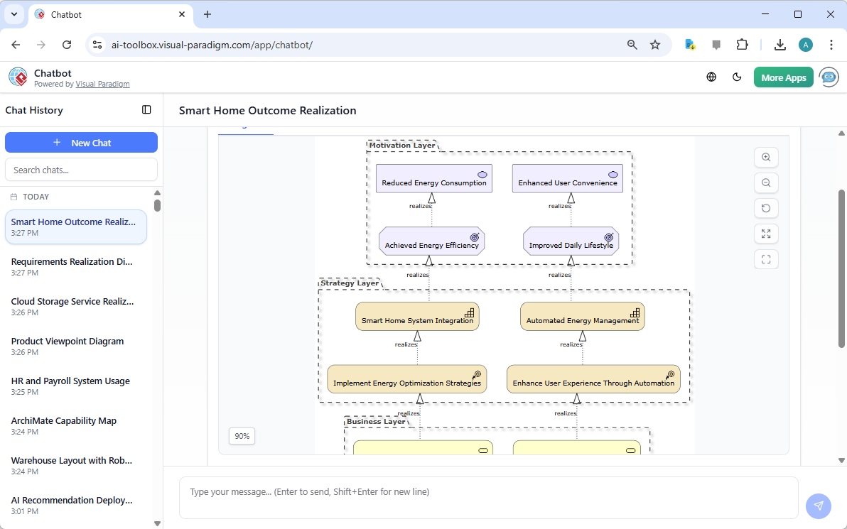

  2. AI Generates Targeted, Traceable ArchiMate Viewpoints The output is one or more purpose-built viewpoints (selected based on your description).
    • Business Process Viewpoint
    • Business Process Cooperation Viewpoint
    • Business Process Realization Viewpoint
    • Goal Contribution Viewpoint
    • Goal Realization Viewpoint
    • Strategy Viewpoint
    • Organization Viewpoint
    • Stakeholder Viewpoint
    • Information Structure Viewpoint

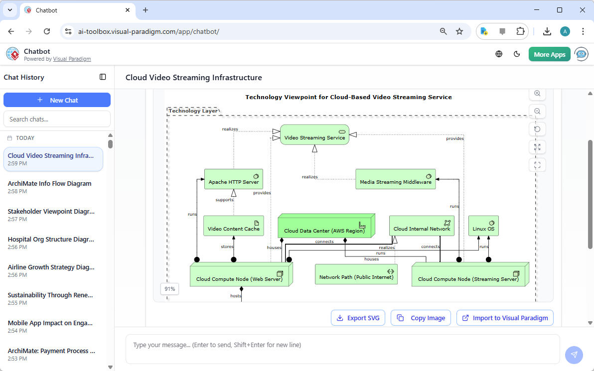

    • Technology Viewpoint
    • Technology Usage Viewpoint
    • Implementation and Migration Viewpoint

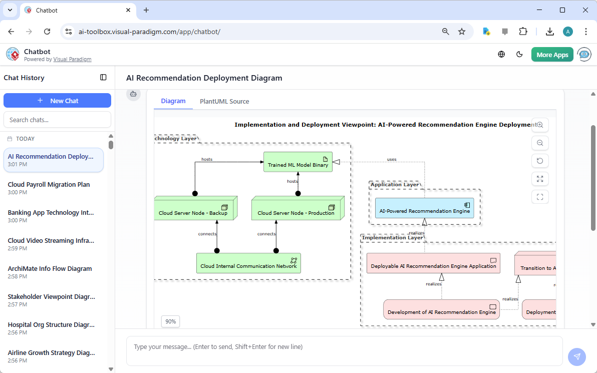

    • Implementation and Deployment Viewpoint
    • Physical Viewpoint

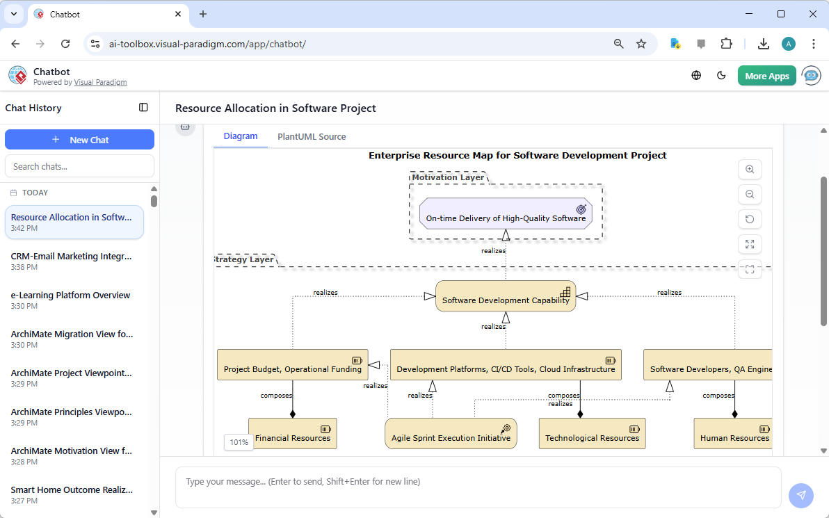

    • Resource Map Viewpoint

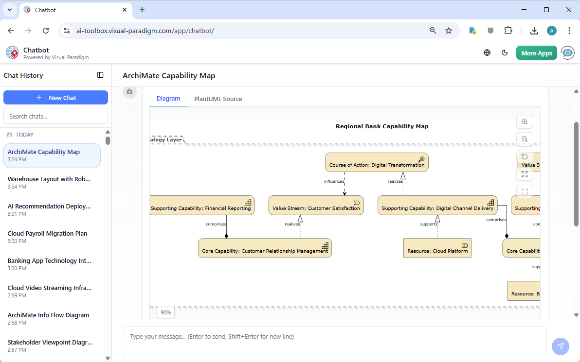

    • Capability Map Viewpoint
    • Application Usage Viewpoint
    • Application Cooperation Viewpoint

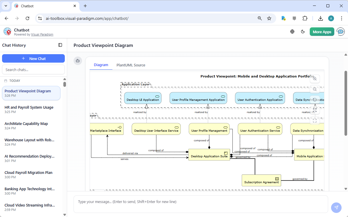

    • Product Viewpoint

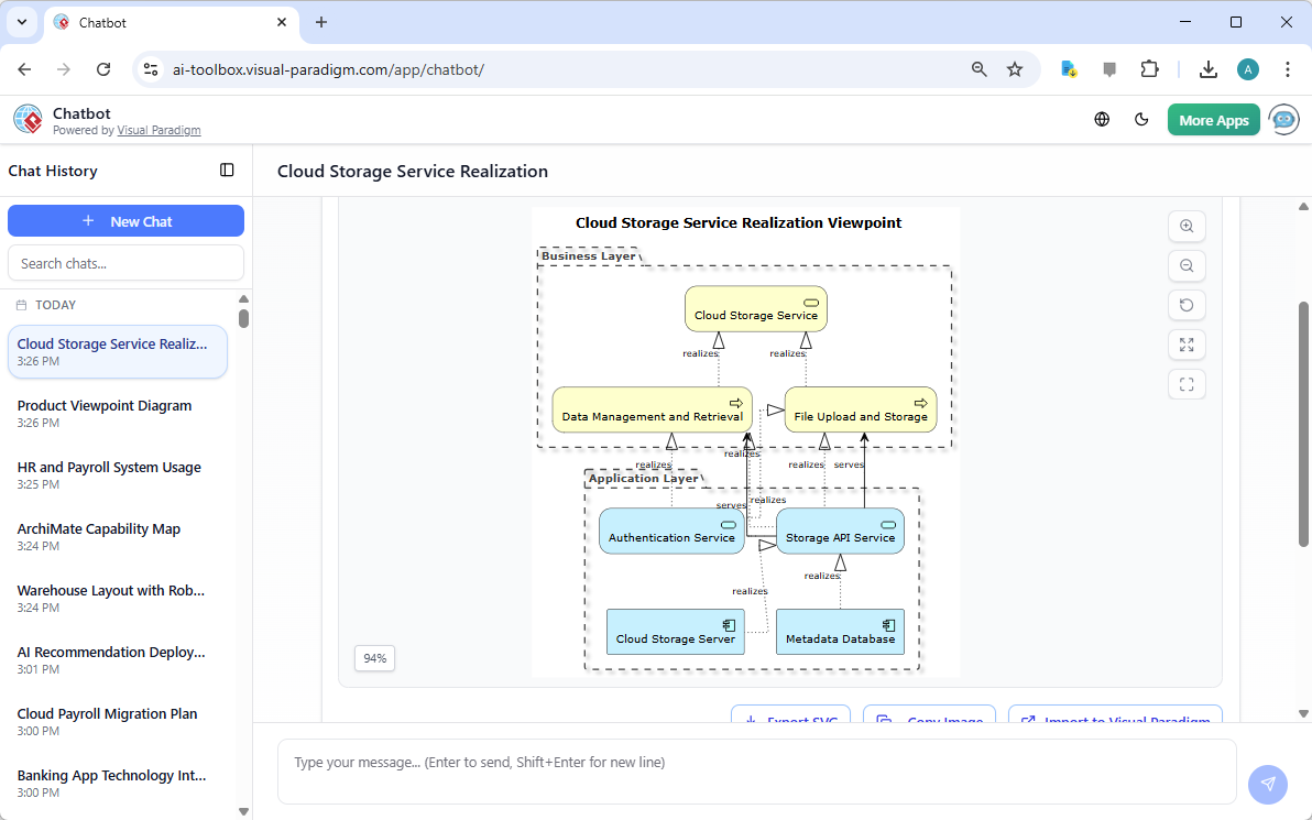

    • Service Realization Viewpoint
    • Requirements Realization Viewpoint
    • Outcome Realization Viewpoint
    • Motivation Viewpoint
    • Principles Viewpoint

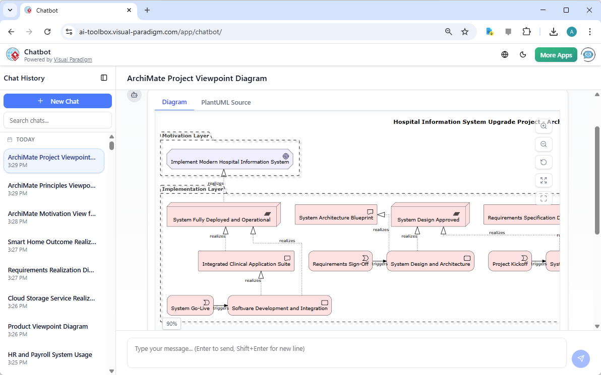

    • Project Viewpoint
    • Migration Viewpoint
    • Introductory Viewpoint
    All elements use correct ArchiMate 3.x notation (rounded rectangles, diamonds, circles, etc.), standard colors (yellow business, blue application, green technology), and appropriate relationship types with directionality.

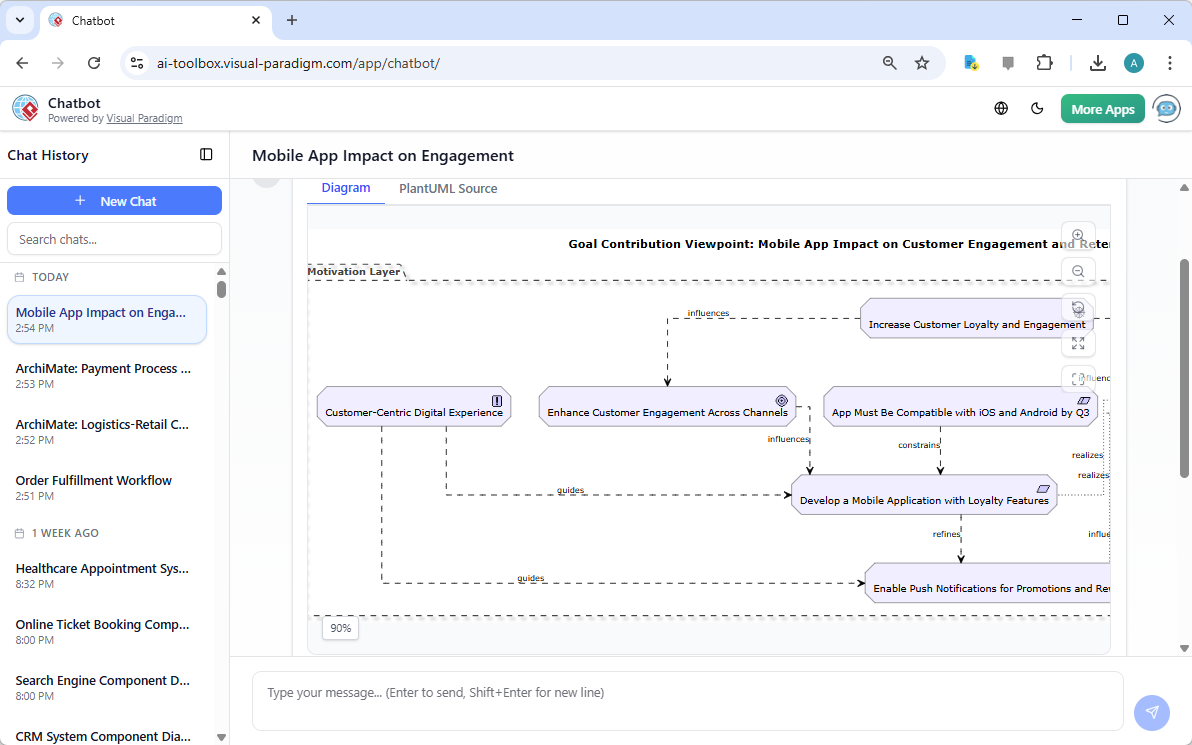

  3. Iterative Refinement & Critique Integration Refine naturally and request integrity checks:
    • “Add a new business driver: regulatory compliance for data privacy. Show how GDPR requirements are realized by encryption services in the Technology layer.”
    • “Create a Gap Analysis Viewpoint comparing current vs. target architecture for migrating from monolith to microservices.”
    • “Perform an architectural review: are there any missing realization relationships or orphaned business capabilities?”
    • “Align this with TOGAF Phase E – Opportunities & Solutions: suggest migration increments.”
    • “Generate the corresponding Stakeholder Viewpoint for the CFO focusing on cost reduction goals.”
    Diagram Touch-Up and cross-model synchronization keep everything consistent—no manual relinking required.
