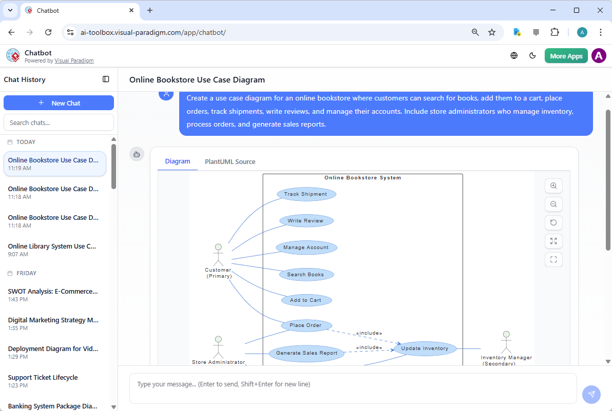

Example prompts that work exceptionally well:
  • “Create a use case diagram for an online bookstore where customers can search for books, add them to a cart, place orders, track shipments, write reviews, and manage their accounts. Include store administrators who manage inventory, process orders, and generate sales reports. ”
    Use Case Diagram for an online bookstore system generated by Visual Paradigm's AI Chatbot
    Use Case Diagram for an online bookstore system generated by Visual Paradigm’s AI Chatbot

  1. Submit the prompt. Within seconds, the AI returns a complete Use Case Diagram featuring:
    • A clearly labeled system boundary rectangle with the system name
    • Actors (stick figures or system icons) positioned logically outside the boundary
    • Use cases (ovals) named as user goals in verb-noun form (e.g., “Search Books”, “Request Ride”, “View Patient History”)
    • Correct associations (lines connecting actors to use cases)
    • Clean, professional layout with minimal crossing lines and readable spacing
