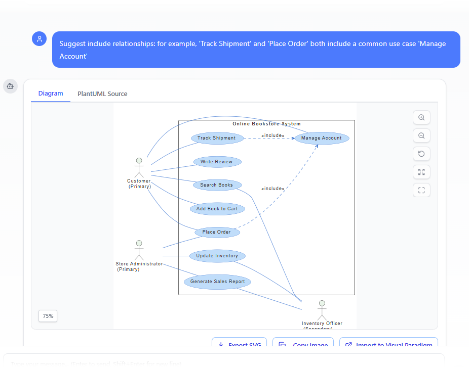

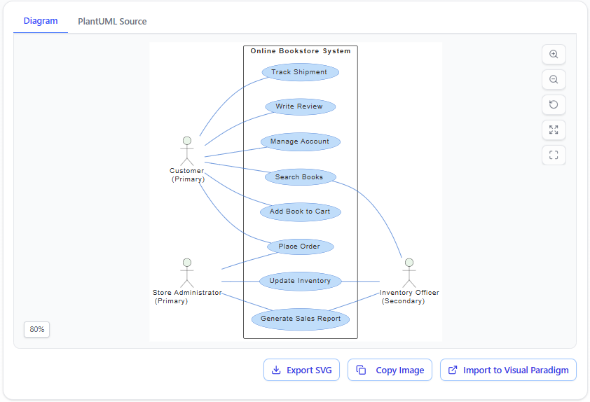

  1. Start with Your Base Diagram Assume you already have a generated Use Case Diagram (from plain English prompts or textual analysis) showing primary use cases and actors.
  2. Invoke Refinement in Natural Language In the AI Chatbot, simply describe the desired behavior or ask for suggestions:
    • “Refine this use case diagram by adding appropriate include and extend relationships.”
    • “Show that ‘Authenticate User’ is included by ‘Place Order’, ‘Track Shipment’, and ‘Write Review’.”
    • “Suggest extend relationships: for example, ‘Apply Coupon’ should extend ‘Checkout’ only for eligible orders.”
    • “Make ‘Handle International Shipping’ an optional extension of ‘Process Order’ when the destination is outside the country.”
    • “Suggest include relationships: for example, ‘Track Shipment’ and ‘Place Order’ both include a common use case ‘Manage Account’”
  3. AI Analyzes and Proposes The AI evaluates:
    • Reusability — Common sub-goals that appear in multiple use cases → strong candidate for «include».
    • Conditional/optional behavior — Variations or add-ons that occur only under certain conditions → candidate for «extend».
    • Semantic fit — Uses linguistic patterns, scenario text, and UML metamodel rules to avoid misuse (e.g., no «include» for optional steps).
    • Best practices — Follows guidelines such as:
      • «include» for mandatory, reusable fragments (base use case is incomplete without it).
      • «extend» for optional or conditional extensions (base use case is complete on its own).
      • Clear extension points named when appropriate.
      • Avoidance of over-fragmentation or circular dependencies.
    It then suggests additions with rationale, e.g.:
    • «include» → “Authenticate User” included by “Place Order”, “Track Shipment”, “Manage Account” Rationale: Authentication is a mandatory prerequisite shared across multiple user goals.
    • «extend» → “Apply Loyalty Discount” extends “Checkout” at extension point “Before Payment Summary” Rationale: Discount is optional and only applies if the customer has loyalty points.
  4. One-Click or Conversational Application
    • Accept all suggestions → AI adds dashed arrows with «include» / «extend» keywords, correctly orients extension points (if named), and auto-adjusts layout.
    • Selective application → “Add only the authentication include relationships for now.”
    • Further refinement → “Rename the extension point to ‘During Order Summary’ and move the ‘Apply Coupon’ oval closer to ‘Checkout’.”

Before (flat list of use cases): Place Order – Checkout – Apply Coupon – Process Payment – Track Shipment – Authenticate User
