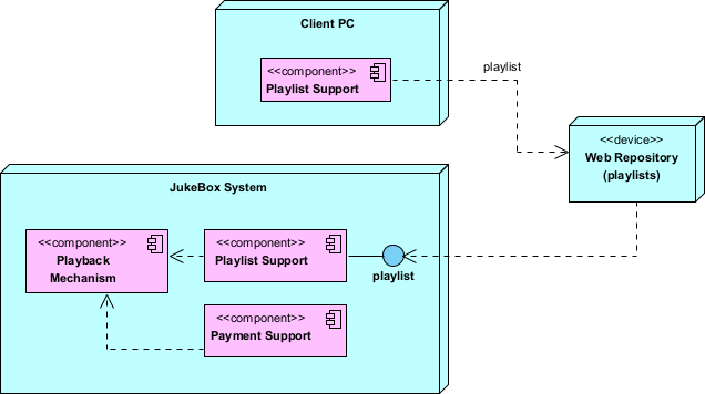

Juke box UML deployment diagram example
Deployment diagrams in UML 2.5 visualize the physical deployment of a software system onto hardware and network infrastructure. They show how software artifacts (executables, libraries, configuration files, databases, containers, microservices, etc.) are distributed across nodes (physical or virtual computing elements such as servers, workstations, mobile devices, cloud instances, IoT gateways, embedded controllers) and how these nodes are connected via communication paths (networks, protocols, buses).
Key elements:
  • Node — A 3D box (cube-like) representing a computational or physical resource (e.g., «device», «executionEnvironment», «node»). Stereotypes clarify type: «server», «cloudInstance», «mobileDevice», «container», «KubernetesPod».
  • Artifact — A file or deployable unit (e.g., .jar, .war, .exe, Docker image, database schema) shown inside or manifested on a node.
  • Communication Path — Solid line between nodes, often with stereotypes or protocols (e.g., «HTTP», «HTTPS», «MQTT», «LAN», «VPN», «5G»).
  • Deployment — Shows which artifacts run on which nodes (manifestation or deployment relationship).
  • Nested nodes — Nodes can contain other nodes (e.g., data center contains racks contains servers).
