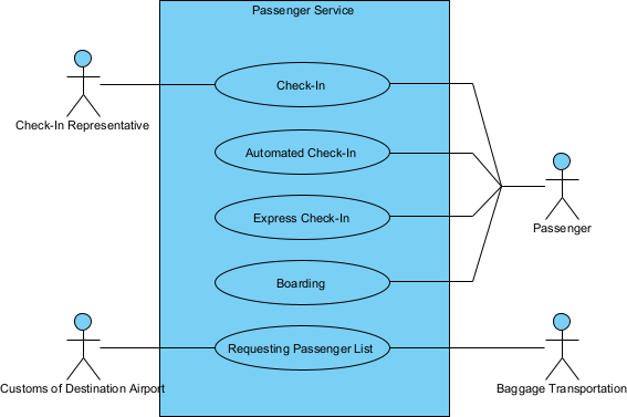

In UML, the Use Case View is primarily expressed through:
- Use Case Diagrams — showing actors, use cases, system boundary, and relationships (include, extend, generalization).
- Use Case Descriptions / Specifications — detailed narratives (flow of events, main success scenario, alternatives, exceptions, preconditions, postconditions).
The key principle: A use case is a complete, meaningful goal that an actor achieves with the help of the system, described at a level of abstraction where the actor can understand and validate it.
